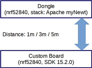

When testing our own board with a module (BT840) for communication range, we obtained the following results:
1. removal for a distance of 1m: 55-70 kB / s
2. removal for a distance of 3m: 15-30 kB / s
3. distance removal 5m: 5-12 kB / s
the experiment is as follows:
Settings:
mtu = 247;
Gap Event Length = 251;
Connection Inerval = 100 ms; (tried and 50, but did not notice the difference);
Power Level: +8 dbm
At the same time, your demo example (ble_app_att_mtu_throughput) shows a stable result at a distance of up to 10m (about 45 - 50 kB / s).
The code that performs the sending of notifications was taken from the example and adapted to our project. But the essence remains the same: adding data to the internal queue before receiving an error (NRF_ERROR_RESOURCES). After receiving an error, waiting for an event: data was sent (BLE_GATTS_EVT_HVN_TX_COMPLETE).
This means that the problem is either in our board or in the dongle. To check our board, I would like to use it in your demo example instead of one of the DCs.

    There is really no code difference that may explain why the throughput is better at short range, the time of flight is speed of light, and the software will not be able to differentiate whether the boards are 1m or 5m apart. Based on this I can not see any code change that may explain your behavior. I think you have a marginal link budget here (maybe some reduction of a few dB due to layout, ground layer, antenna, obstructions, casing or similar..) and when you move the boards away from each other, then you get more influenced by interference source. In specific when you have large packets the risk of packet loss due to interference is increased. Also when you have a 100ms connection interval, if any packet is lost, the peers will wait until next interval before it will proceed, this means that the throughput rapidly is reduced if you have even a small increase in packet loss.

  • Yes, we have it. Max range is about 7m.
    But we can not understand what the problem is:
    1. our production dongle on module BT840 (nrf52840) with apache stack;
    2. not quite a good option psb main device (the presence of shield, battery nearby);
    Therefore, we want to exclude one option from consideration, replacing it with a proven node (in this case, the PDK).
    Well, I will try to replace the board description file with my own. I think in one or two days I will have a test result
  • Sounds like a good plan to try to find if it's dongle or main device that the problematic design here.
    If the max range is only 7m, then it is very likely that the problem is poor link budget. So maybe you can also contact module manufacturer and ask them to review your module placement in your design.
    If you send both dongle and main device to us we likely can measure the antenna and output power on both boards and provide recommendations.
    Kenneth
    So, I made minimal changes to the project of the example, namely: I refused to press the button, but just made a call to the desired configuration at the start. That was enough.
    Further, several experiments were conducted with this code and obtained the following results:
    1. PDK (tester) + PDK (dummy): average 500 kbit\s on distance ~10m;
    2. PDK (tester) + Our board (dummy) average 450 kbit\s on distance ~10m;
    3. Our dongle (tester) + Our board (dummy) average 80 kbit\s on distance ~3m;
    Problem device found! Waiting for an answer with recommendations from Fanstel.
