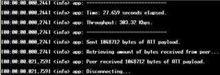

the result I got is about 300 Kbps, only 30% of 1000 Kbps as expected:

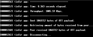

However, I then use the same hardware but with v14.2.0 SDK and the same throughput example project included in this version of the SDK.
Now I achieved over 1000 Kbps throughput!

Why I could only achieve 300 Kbps throughput with the latest v15.2.0 SDK?
