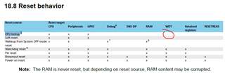

  • Hi Charles,
    Q1: According to the ARM Cortex-M4 Devices Generic User Guide
    The processor enters a lockup state if a fault occurs when executing the NMI or HardFault handlers. When the processor is in lockup state it does not execute any instructions. The processor remains in lockup state until either:
      • it is reset
      • an NMI occurs
      • it is halted by a debugger.
    as the lockup it self will cause a the chip to reset and you do not have a debugger connected then I would have to say no, its not possible for the core to remain in a locked up state with no debug hardware connected.
    Q2: Do not think that this is possible as stated in Q2. Will confirm this internally.
  • HI Charles, I just realized that a reset caused by a CPU lockup will not clear the Watchdog. So if the CPU lockup occurs and then the WDT will still be running after the reset and then timeout.
  • I see, so if there isn't any errata that applies here, two possible scenarios are:
    1. We're in an infinite loop somewhere, WDG resets us, and we enter a core lockup before we check + clear RESETREAS.
    2. We experience a core lockup, and when we reset, we enter an infinite loop before we check + clear RESETREAS.
    In both scenarios, the end result is LOCKUP | DOG set in RESETREAS.
    This is plausible; we save state in a section of RAM that we retain across resets; if that's getting corrupted we might see issues like this.
    Anyway, it sounds like there aren't any errata that apply, and that if we see LOCKUP | DOG in RESETREAS, it's real and being correctly reported.
    If that's the case, then let's close this ticket. Thanks for your help!
