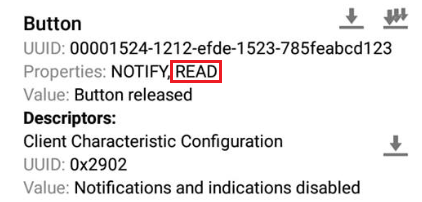

Hello. I am using the nordic thingy 52 sdk to program my thingy. I have seen that the temperature values are sent to the client based on a timer. I wanted to ask if there is any way one can change this such that these temperature values are only read when requested by the client.

  • I forgot to add the link in the previous answer (here it is).
    However, in order to enable the read property for a characteristic, you have to modify the actual code. Look at step 2.F in the mentioned tutorial.
    You can confirm that you have done it correctly by donwloading nRF Connect, and connecting to the Thingy. Then you should see the READ property as shown in the image below. You can read the characteristic value by pushing the arrow beside the three arrows.
