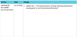

I want to buy a nRF91 DK from digi-key, however I saw some errata on the matching network for the GPS antenna for nRF9160 DK v0.7.0 and v0.8.2.
Does the version being sold have this issue or was it fixed pre-release?
What version is being sold?
Attached is errata from documentation.

  • For what it's worth, Peder Rand stated on the nRF9160 Development Status post somewhat recently:
    "[GPS Matching Network] I don't think we have good values that will work with the LTE antenna so close. Hence the recommendation to use external antenna for now until we have found a better on-board design."
    I would assume this means that the v0.8.3 that I bought will have the issues I was trying to prevent. Just following up if anyone else has this question. Please correct me if I am understanding wrong.
