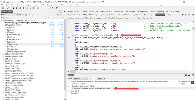

  • Hi.
    Following the guide you were suggesting, I get errors while trying to compile. In order to ascertain were is the problem, I am adding the five scripts being mention in this guide (SDK configuration header files, DFU event handler, enable auto shutdown retry, implement the power management and Initialize de Buttonless Secure DFU Services) one at a time, and running a Build immediately after each script has been pasted.
    As soon as I reach the "DFU event handler" script, I get the following error:
    Would you mind telling me what is wrong?
    Thanks
