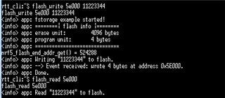

I use nrf52832 SDK14.2 for development, I copy the flash_fstorage example code to my project.
I write the data to flash doesn't have any error, and can read flash data successfully. But if I reboot and read the flash again the data is wrong.
Below is my code :

Write 0x11223344 to flash address 0x5e000 doesn't show error, and can read successful
But if I reboot, and read again. The data in flash address 0x5e000 is 0.
Anyone know why ?
