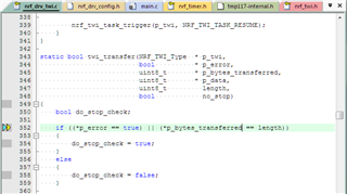

Stuck in twi_transfer() when using BLE and Timer
This error has been bugging me for few days and I still have no luck in troubleshooting it.
Recently, I just changed my work project from nrf51822 device to nrf52832. I am planning to develop a system which it could communicate with a temperature sensor using TWI, then send data across BLE within a specific time interval. I have combined these 3 examples into my project:
  • ble_app_uart
  • timer
  • twi_sensor
The ble_app_uart and timer work perfectly fine at first. But problem occurs when I integrated twi_sensor source code on top of it. When I looked into the code lines using JTag debugger console, it seems like the program always stuck inside the twi_transfer() loop.
I have tried to look into the similar issue raised by others in this community, and found that the multiple/nested interrupt priorities might be the culprit. I have followed some guidance from this thread but still no luck to resolve it.
These are some sections of my code. Most of the structures are based on the example files. I am using pin 0.10 for SCL and pin 0.03 for SDA. The temperature sensor is TMP117 and I am pretty sure it has no hardware/register errors (Have tested the temperature sensor module with Arduino Uno and it works just fine).

Functions for TWI modules:
 * @brief Function for setting TMP117 temperature sensor
void TMP117_set_mode(void)
    ret_code_t err_code;
    // Writing to registers
    uint8_t reg1[3] = {0x02, 0x0D, 0x80};
    uint8_t reg2[3] = {0x03, 0x0C, 0x00};
    uint8_t reg3[3] = {0x01, 0x02, 0x20};
    uint8_t reg4[3] = {0x07, 0x00, 0x00};
    err_code = nrf_drv_twi_tx(&tmp117_twi, TMP117_ADDR, reg1, sizeof(reg1), false);
    err_code = nrf_drv_twi_tx(&tmp117_twi, TMP117_ADDR, reg2, 3, false);
    err_code = nrf_drv_twi_tx(&tmp117_twi, TMP117_ADDR, reg3, 3, false);
    err_code = nrf_drv_twi_tx(&tmp117_twi, TMP117_ADDR, reg4, 3, false);
    //while(m_set_mode_done == false);
 * @brief TWI events handler.
void twi_handler(nrf_drv_twi_evt_t const * p_event, void * p_context)
    static sample_t m_sample;
    switch(p_event->type)
        case NRF_DRV_TWI_EVT_DONE:
            if ((p_event->type == NRF_DRV_TWI_EVT_DONE) &&
                (p_event->xfer_desc.type == NRF_DRV_TWI_XFER_TX))
                if(m_set_mode_done != true)
                    m_set_mode_done  = true;
                    return;
                m_xfer_done = false;
                /* Read 2 bytes from the specified address. */
                err_code = nrf_drv_twi_rx(&tmp117_twi, TMP117_ADDR, (uint8_t*)&m_sample, sizeof(m_sample));
            else
                m_xfer_done = true;
        default:
 * @brief TWI initialization.
void twi_init (void)
    const nrf_drv_twi_config_t twi_config = {
       .scl                = 10,
       .sda                = 3,
       .frequency          = NRF_TWI_FREQ_100K,
       .interrupt_priority = APP_IRQ_PRIORITY_HIGH
    err_code = nrf_drv_twi_init(&tmp117_twi, &twi_config, NULL, NULL); //Disable handler for testing purpose (But still no luck)
    nrf_drv_twi_enable(&tmp117_twi);
Timer event handler:
 * @brief Handler for timer events.
static void clock_timer_handler(void *p_context)
    uint8_t temp_data[2] = {0, 0};
    unsigned char msg[20] = {"\0"};
    sprintf((char*)msg, "Ready");
    ble_nus_string_send(&m_nus, msg, 20);
    //err_code = nrf_drv_twi_rx(&tmp117_twi, TMP117_ADDR, temp_data, 2);
    //APP_ERROR_CHECK(err_code);
    sprintf((char*)msg,"Temp: %d\n", temp_data[0]);
Main function:
    uint32_t err_code;
    bool erase_bonds;
    unsigned char data_buffer[20] = {"Initialising...\n"};
    // Initialize.
    uart_init();
    twi_init();
    TMP117_set_mode();
    APP_TIMER_INIT(APP_TIMER_PRESCALER, APP_TIMER_OP_QUEUE_SIZE, false);
    ble_stack_init();
    gap_params_init();
    services_init();
    advertising_init();
    conn_params_init();
    err_code = NRF_LOG_INIT();
    err_code = ble_advertising_start(BLE_ADV_MODE_FAST);
    //Configure TIMER for broadcasting data
    err_code = app_timer_create(&clock_timer, APP_TIMER_MODE_REPEATED, clock_timer_handler);
    err_code = app_timer_start(clock_timer, APP_TIMER_TICKS(5000, APP_TIMER_PRESCALER), NULL);
    ble_nus_string_send(&m_nus, data_buffer, 20);
    uint8_t reg = 0;
    // Enter main loop
    for (;;)
        do
            power_manage();
        while(m_xfer_done == false);
        err_code = nrf_drv_twi_tx(&tmp117_twi, TMP117_ADDR, 0x00, 1, true);

#define TWI0_ENABLED 1
#if (TWI0_ENABLED == 1)
#define TWI0_USE_EASY_DMA 0
#define TWI0_CONFIG_FREQUENCY    NRF_TWI_FREQ_100K
#define TWI0_CONFIG_SCL          0
#define TWI0_CONFIG_SDA          1
#define TWI0_CONFIG_IRQ_PRIORITY APP_IRQ_PRIORITY_LOW
#define TWI0_INSTANCE_INDEX      0
