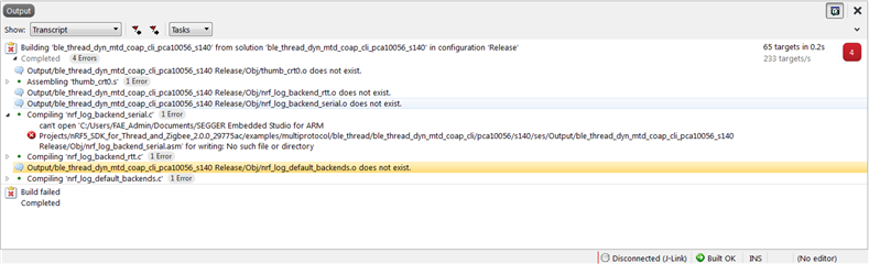

right now I'm trying the example with Dynamic multiprotocol examples using nrf52840 Thread and Zigbee SDK, but when I build it, for example : BLE Proximity and Thread CoAP Server Example. It shows this error. I placed the SDK in Documents\SEGGER Embedded Studio for ARM Projects . Other simple example with coap_server and coap_client can be compiled without any error and run perfectly on board. I'm using BMD340 Evaluation Kit from Rigado right now.

    Thanks confirming the issue. Assume you aren't on windows 10.
    The micro-ecc library must be compiled using the makefile/build scripts as we don't have a segger project for it. To install uecc you first need to have the GCC toolchain (win download link), GNU make (link - make sure to export make.exe to PATH) and Git installed. Once you have these installed you can run  build_all.bat script in /external/micro-ecc. This will fetch the uecc source and build the library for all targets.
