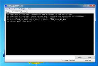

I changed NRF_SDH_BLE_VS_UUID_COUNT with 1 in 2.

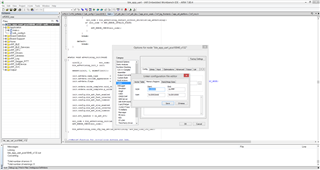

I modify RAM start and RAM STOP in IAR.
How do start work DFU? I use function ble_dfu_buttonless_bootloader_start_finalize(); but she not started DFU.
