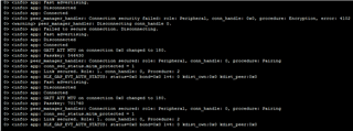

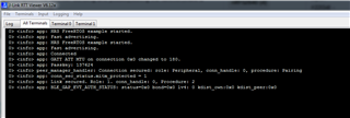

Hi all
nrf52840 Development board,sdk is nRF5_SDK_15.2.0_9412b96,PC is windows 10
I want to add the function about bonding and passkey to the example of "ble_app_hrs_freertos",so I use the example of "ble_app_gls",
but after I transplant the function bonding and passkey,testing the function,there is something wrong,as follow:
I hope you can give me some advice.Thank you!
  • It most likely could be from sd_ble_gap_sec_params_reply which says
     * @retval ::NRF_ERROR_INVALID_ADDR Invalid pointer supplied.
    Assuming that you have not done any additional changes apart from trying to merge these two exampels, it could be a stack corruption, did you try to increase the stack size in FreeRTOSConfig.h
    That is increase the value of this configMINIMAL_STACK_SIZE. If this does not work, then you need to tell us more about what changes you did.
  • Thank you for your answer,I increased the value of this  configMINIMAL_STACK_SIZE from 60 to 300 and configTOTAL_HEAP_SIZE from 4096 to 8192,but the same error occurred.I track debugging with the error,the reason for it is calling the sd_ble_gap_sec_params_reply just like you say.The follow is the file of main.c which has been changed by me according to the project of ble_app_hrs_freertos,looking forward to your reply.

    /**@brief Function for handling Peer Manager events.
     * @param[in] p_evt  Peer Manager event.
    static void pm_evt_handler(pm_evt_t const * p_evt)
        bool delete_bonds = false;
    		ret_code_t err_code;
    		NRF_LOG_INFO("pm_handler_on_pm_evt");
        pm_handler_on_pm_evt(p_evt);
    		NRF_LOG_INFO("pm_handler_disconnect_on_sec_failure");
    		pm_handler_disconnect_on_sec_failure(p_evt);//new
    		NRF_LOG_INFO("pm_handler_flash_clean");
        pm_handler_flash_clean(p_evt);
    		NRF_LOG_INFO("p_evt->evt_id = %d",p_evt->evt_id);
        switch (p_evt->evt_id)
    				case PM_EVT_CONN_SEC_SUCCEEDED:
    					pm_conn_sec_status_t conn_sec_status;
    					// Check if the link is authenticated (meaning at least MITM).
    					err_code = pm_conn_sec_status_get(p_evt->conn_handle, &conn_sec_status);
    					if (conn_sec_status.mitm_protected)
    						NRF_LOG_INFO("Link secured. Role: %d. conn_handle: %d, Procedure: %d",
    									 ble_conn_state_role(p_evt->conn_handle),
    									 p_evt->conn_handle,
    									 p_evt->params.conn_sec_succeeded.procedure);
    					else
    						// The peer did not use MITM, disconnect.
    						NRF_LOG_INFO("Collector did not use MITM, disconnecting");
    						err_code = pm_peer_id_get(m_conn_handle, &m_peer_to_be_deleted);
    						err_code = sd_ble_gap_disconnect(m_conn_handle,
    				} break;
    				case PM_EVT_CONN_SEC_FAILED:
                advertising_start(&delete_bonds);
            default:

  • Today,I debug the example again,I find when I set
    (#define SEC_PARAM_LESC    1 ) ,the error is repetition .
    I don't know if there some point to use this parameter.
    when I delete relevant code about this parmeter,it can set passkey. I'm very confusion.
  • something is different with your peer-manager_init function? can you attach your project for me to test it?
  • Certainly.But I don't know how to post my project in this forum.
    I don't chang the peer-manager_init function.So far,LESC can be used,but there is also something wrong with my code.When I disconnect the device,hard fault willl appear.also error will appear when switch with in everal mobile phones to test the code.
    The log as follows:
     0> <info> app: HRS FreeRTOS example started.
     0> <info> app: Fast advertising.
     0> <info> app: Connected
     0> <info> app: Passkey: 415201
     0> <info> app: BLE_GAP_EVT_LESC_DHKEY_REQUEST
     0> <info> nrf_ble_lesc: Calling sd_ble_gap_lesc_dhkey_reply on conn_handle: 0
     0> <info> peer_manager_handler: Connection secured: role: Peripheral, conn_handle: 0, procedure: Bonding
     0> <info> app: conn_sec_status.mitm_protected = 1
     0> <info> app: Link secured. Role: 1. conn_handle: 0, Procedure: 1
     0> <info> app: BLE_GAP_EVT_AUTH_STATUS: status=0x0 bond=0x1 lv4: 1 kdist_own:0x3 kdist_peer:0x2
     0> <error> hardfault: HARD FAULT at 0x00000000
     0> <<info> app: HRS FreeRTOS example started.
     0> <info> app: Passkey: 265692
     0> <info> app: Disconnected
     0> <error> hardfault: HARD FAULT at 0x41000000
     0> <e<info> app: HRS FreeRTOS example started.
     0> <error> app: ERROR 8198 [Unknown error code] at :0
     0> PC at: 0x00000000
     0> <error> app: End of error report
