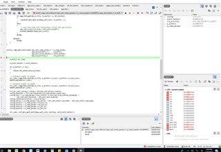

i am using nrf52382 , merged the uart , timer and twi .while debugging i am getting the error unknown function 0x000008C8

  • Most likely you get an error on the UART peripheral, which is passed on to error handler. The errors reported from UART driver, usually corresponds to the errors in ERRORSRC. From your image it looks like the error code is 4, or a FRAMING error. Did you run this on a custom board, or a nRF52 DK? Try running the code one more step, to see what is assigned to error_info struct. Then check the code on the given line number to see if you can catch the error when it is coming in.
  • i am using custom board nrf52832  ,  i ran the program step by step , it getting error while it entering the
    uart_app. see the pic you can clear get

  • its entering the uart_init(); successfully and when it goes to app_uart_init () on this case i am getting this error
