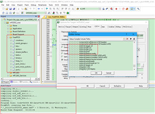

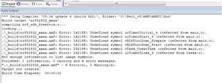

  • The project port is NOT complete Wang. I have looked into both ble_app_uart_c arm4 version of your project and also the arm5_no_pack version of your project. None of it has any FreeRTOS source files or its headers included. Atleast send me a project your used to compile and flash your device so that i come to a stage to be able reproduce your problem, I do not want us both to spend too much time  in trying to debug compile issues. Please look and test the project on your side and update the project so that it compiles
