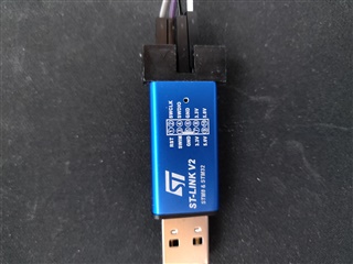

- ST-LINK tools (https://github.com/texane/stlink) + OpenOCD 0.10.0+dev-00656-gd140fb2 (installed by following the procedure in the description box https://www.youtube.com/watch?v=BzTcqwFI1m4&t=1s)

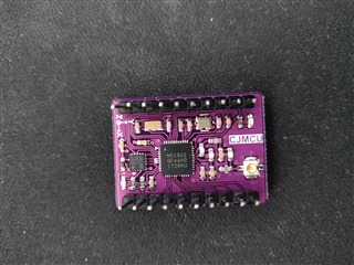

Different nrf51822 boards from aliexpress:
ST-LINK V2

Now I would like to compile the blinky example for my nrf51 boards, but the examples only have configs for nrf52 afaik.
How can I make blinky run on my nRF51 boards? What do I have to change in the Makefile? Is the SDK15 even compatible for nRF51 and nRF52 chips?
