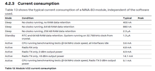

  • Hi Hung,
    Thank you for your reply.
    I can not judge whether I can buy a profiler kit, so I will consult with my boss.
    I understood a little about the function of softdevice. Thank you.
    You said softdevice grants to slot of time to mesh stack,
    but how long is that regular interval? (ms)order? (us)? (sec)?
    In the office where Bluetooth communication flies from the keyboard or mobile,
    when measuring current consumption using a USB type ammeter, it got about 15 mAh.
    I think this is a bit too much.
    I attach the data sheet of the module I am using.
    current_datasheet
    This document says that it is irrelevant to software, but it seems to be 4.8 mA in RX only.
    This is close to value that you said(5-8 mA) .

  • Hi Wataru,
    To get an overview of what the current consumption should be please have a look at section 5.2 in the NRF52840 product specification v1.0
    Note that the current consumption of 6.4 mA achieved when you enable DCDC. If no DCDC enabled the current consumption when scanning can get up to 12mA.
    Could you try to measure current consumption on an unmodified mesh light switch client example ? I measured the current consumption and it matched with the above number.
    I would suggest to do measurement on a nRF52 development kit as a golden sample to compare to the 3rd party module.
    I don't have the exact number of how often the timeslot is requested. As far as I remember we re-request the timeslot every 10 seconds.
