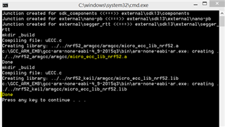

  • Thanks for porting the project to SES!!
    Unfortunately my build failed with error "core_cm4.h : No such file or directory" in nrf52.h
    In the pre-req I ran the setup_sdk.bat from my Win8 PC what looks like successfully building micro_ecc_lib_nrf52.a and .lib
    I did all the 4 pre-required steps before running setup_sdk script. What am I missing?
