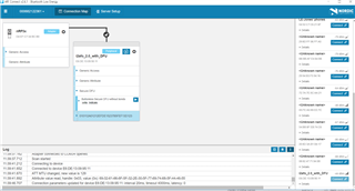

After that, I followed the steps described here: https://github.com/gamnes/nRF52832-buttonless-dfu-development-tutorial, in order to a) create our own bootloader using our own private/public key pair, b) Create our own FW.zip package which we can upload to the device over wireless DFU and c) Create a product release image including all components. Both b) and c) use an application.hex file generated from the extended BLE application with the Buttonless DFU service added as described above. Ultimately, I was able to flash all components (bootloader and correct settings generated in c), softdevice and application) onto one of the nRF52 boards. I then flashed the other one with the nRF Connect app firmware and was able to connect with the BLE peripheral board. I could see both the custom service (which is associated with the already existing BLE application) and the DFU service, as shown below:

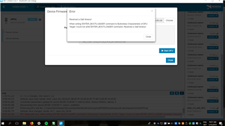

I then click the DFU button also shown and tried to flash the zip.file generated in b), which contains the softdevice + application with updated adv name, in order to be able to double check the update's success. However, after waiting some time (and the nRF connect app being stuck at "initializing"), I get the following error message:
Since then, I've been trying to find the solution to this problem... I've tried adding some things that are not in my application but are in the buttonless DFU BLE example code, such as:
  • Setting BLE_DFU_ENABLED from 0 to 1. Seems logical to do so, as it is said in the comments that in such a way, I enable DFU Service. But this is not described in the documentation as part of adding the DFU service to an existing BLE application (https://www.nordicsemi.com/DocLib/Content/SDK_Doc/nRF5_SDK/v15-0-0/service_dfu).
  • Initialize the async SVCI interface to bootloader, in the services_init(void) method. This is also something that is done in the buttonless DFU BLE example but not described in the documentation as part of adding the DFU service to an existing BLE application. It consists of calling "ble_dfu_buttonless_async_svci_init()". However, when I implement this, my code is stuck in the internal SVC method "sd_softdevice_vector_table_base_set(NRF_UICR->NRFFW[0])" and thus doesn't work at all anymore... I'm not sure if I need to add this, and if so, what else I need to do to get it working this way?
So, to summarize, so far my efforts to find the solution have been in vain. I'm at a bit of a loss here and don't know at all what else I'm missing / doing wrong.
Thank you in advance for having a look at this question and assisting me in finding a solution.
Mathias

    In order to get the BLE stack to correctly initialize I also had to change the application ram start address from 0x20002AA8 to 0x2002F90. While adjusting the RAM start address I also noticed that the ROM size for the application was set to 0x5A000, i.e. the application uses the entire flash from 0x26000 to 0x80000. In order to fit the bootloader together with the application this need to be adjusted to 0x52000 ( Bootloader Start Address(0x78000) - Application Start address(0x26000) = 0x52000).
    After sorting that I un-commented the code in services_init() that initializes the async SVCI interface. As you've stated after compiling in ble_dfu_buttonless_async_svci_init() the code hangs. Stepping though the code I saw that it actually got stuck after calling the NRF_LOG_INFO macro in the first nrf_dfu_svci_vector_table_set() call.
    Since you're using SEGGER_RTT_WriteString directly instead of the NRF_LOG_ - macros I disabled the logging module by setting
    #define NRF_LOG_ENABLED 0
    in sdk_config.h. After recompiling the application I generated a new key pair, put the public key in the bootloader code, compiled and flashed the bootloader, generated a new settings hex file with the application hex as input in nrfutil and finally generate a new .zip package that is signed with the private key.
    I used nRF Connect for Desktop to perform a DFU with the newly created .zip package and the DFU was successful. I also did multiple subsequent DFUs with the same package and all were successful.
