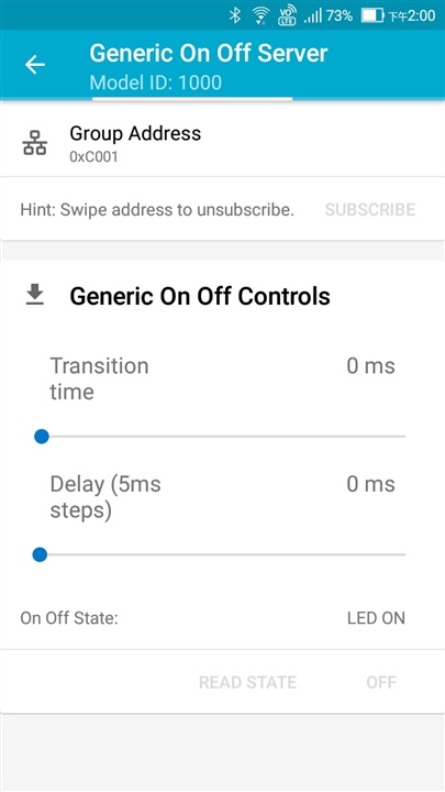

I am playing the light switch example with nRF mesh app.
I am using nRF Mesh app read the light server state. and find out the app is really easy to hang when the device is not ack back the data.
The client has "send_reliable_message()" to make sure the data ack, but how about the command from proxy.c?
How can I handle it that App will not wait forever?
