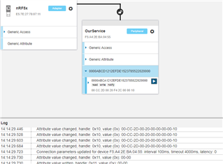

I'm triyng to send a simple vector with ble but what i receive was different.
aniway what  i want to send is something like this:

and the function i used was :
        err_code = ble_os_value_update(&m_our_service,*dati);
in my_service.c I initialize this function as:
uint32_t ble_os_value_update(ble_os_t * p_os, uint8_t custom_value)

but what i receive was :
in fact obviusly 00-CC-2D-00-20-00-00-00-00-10 is different from thw 10 zero vector i send....so what's wrong?
can someone help me?
