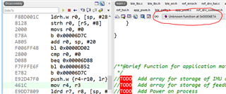

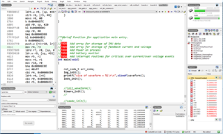

Here is what happens.  After a random time in seconds to hours, the system just hangs with an undefined function:
  • I accidentally hit POST - here is the continuation -
    In case you cannot read the image above, the message on the SEGGER IDE is: Unknown function at 0x00006E7A.  When the system hangs it is still "running" and I hit the stop button to get this output.

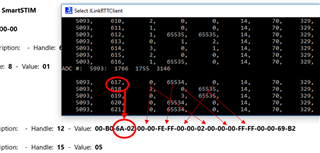

    Here is a snapshot of the JLINKRTT Client with the output of the PC tool Bluetooth LE explorer.  Note how the packets are formed from the data collected from the IMU.
    What seems odd is the the system is most reliable using the nRF Master Control Panel..  However, the error occurs on both our custom MCU board and the nRF52 DK board.
  • Here is a further update on the issue.
    I have run the Nordic Master Control Panel PC tool with our target MCU continuously since yesterday at about 6 pm (almost 13 hours).  This is the configuration that I have indicated running overnight on previous occasions.  The test is still running.  There must be some unique handling that the Nordic Master Control Panel uses to work well on the PC.  We need further help on this.  It may be due to the PC BLE drivers for the standard PC installation.  The Nordic Master Control Panel uses its own USB dongle for the BLE connection instead of the native PC BLE hardware.  See below the 2 traces being run showing SmartSTIM Burst 12691 and the data from sample 1254 in the MCU trace (JLinkRTTClient) correlating to the highlighted line in the Master Control Panel trace.

    I think the "undefined function" is just a arbritrary SoftDevice process that is common to hit if you manually stop the program execution at a random point in time.
    Do you have some more information on the nature of your symptom itself? "After a random time in seconds to hours, the system just hangs..." is not enough information.
    Are you missing packets, sensor samples corrupted, or something like that?

    As shown in the diagram above, the last packet that contains packet 618 data is just fine.  The next packet for samples in 619 and 620 never make it.  The firmware starts to pack the samples for the next BLE transmission and the system hangs up.  Note that if I use the Nordic Master Control Panel with the nRF51 dongle, the transmissions seem to go forever - I have run tests for more than 24 hours without an issue.
