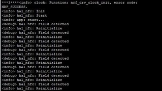

I'm using nRF52832 on a custom board and I have tried to run sdk example nfc_url_record, but it doesn't work.
I have tried to find solution  among existing answers to such  topics, but no results (.
I don't know what is the reason. The only result I could get was information from log module:
I have checked all analog part on the board, and there is a strong signal on NFC pins. And resonance frequency corresponds to the desired.
