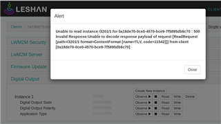

I have flashed LWM2M client in a Nordic Board and can see this listed in my LWM2M server. There was no error during bootstrapping( Since device is visible in LWM2M server).  Now when i try to on LED 4 by writing 'true' nothing changing on the board, rather having an error like this:
Unable to read instance /3201/1 for 0a18de70-0ce0-4570-bce9-7f5895db6c70 : 500 Invalid Response:Unable to decode response payload of request [ReadRequest [path=/3201/1 format=ContentFormat [name=TLV, code=11542]]] from client [0a18de70-0ce0-4570-bce9-7f5895db6c70]
Any idea what might have gone wrong ?
