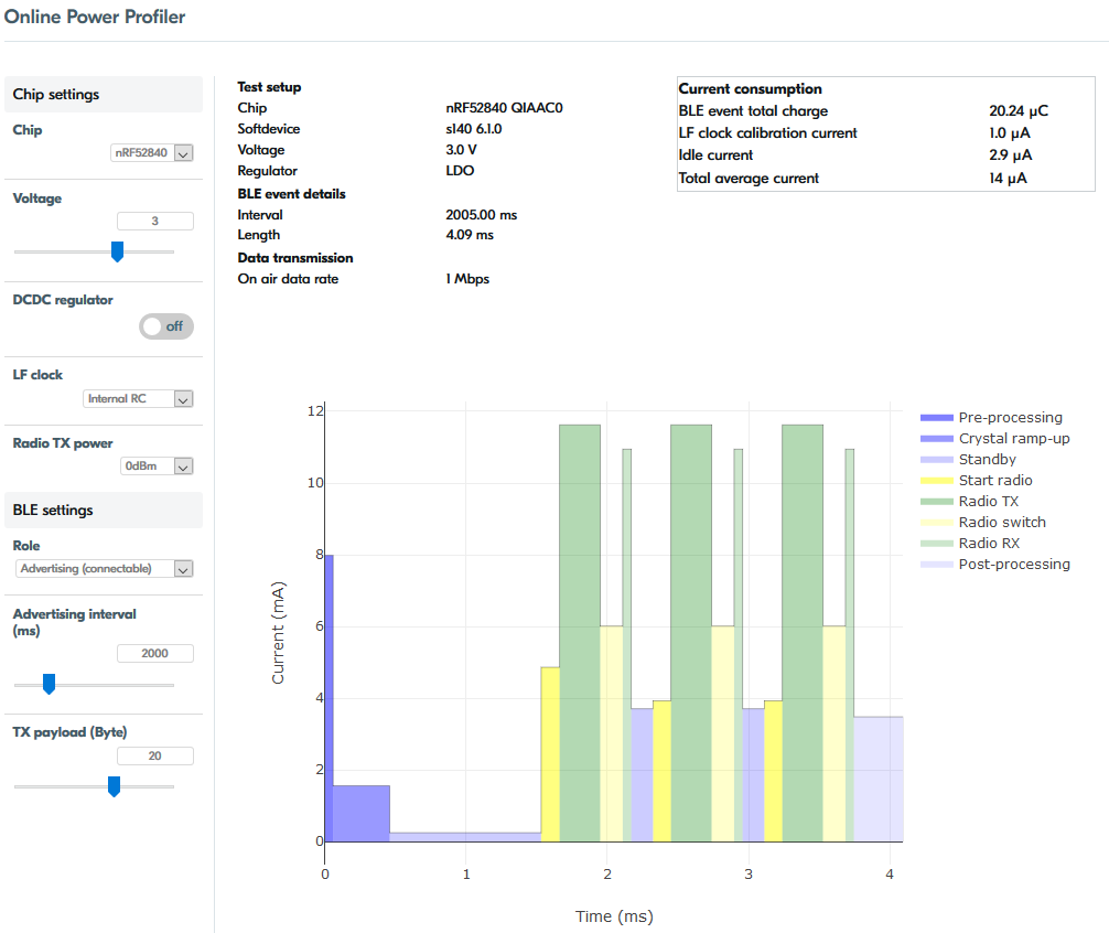

Hi Support team,
The Online Power Profiler is calculating the Average Current  consumption for nRF52840 DK board in a wrong way.
Calculation is of blocks. => Pre-processing,  Crystal ramp up, Standby, Start radio .. and so on
Take a block, say, Pre-processing. In case of my trial,
Current 8 mA over 60 us is Average Current over that period. It is NOT Total Current.
So, when averaging out for the final result of Total average current, it is not (sum of all current from blocks) divided by (Total time).
Rather it should be sum of (current from block  *  length in time) divided by total time.
E.g. above,
(8 mA * 60 us) + (Crystal ramp up current * its length time) + (Standby current * its length time) + (Start Radio current * its length time) + .... divided by Total Time (4.09 ms).
This leads to Average current for the above example, 4.93 mA

Kindly correct the Online Power Profiler !
Thanks !
  • This tool calculates the average current consumption given a set of parameters, one of those parameters is the advertising interval. With an interval of 1000ms the average current consumption will be (4.93mA * 4.09ms + sleep current * (1000ms - 4.09ms)) = 24µA
    The average current consumption during an advertisment event with your parameters is indeed 4.93mA, but this event occurs only once every second for 4.09ms.
  • Thank you for the information.
    I understood.
    Since the graph / Test Setup details /  description did not mention this, instead shows only the advertising section, I was confused.
