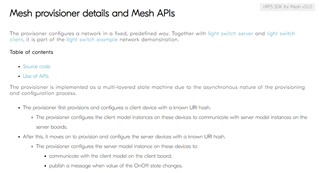

What I'm trying to do:
 I've read this part of the Mesh documentation:
and it seems that the provisioner connects to a client via a URI. I've traced the m_nw_state variable all throughout main.c in the light_switch_provisioner_nrf52840_xxAA_s140_6.1.0 example, as it seems that m_nw_state.p_client_uri is the URI passed to the following function:
static const char * server_uri_index_select(const char * p_client_uri)
    if (strcmp(p_client_uri, EX_URI_LS_CLIENT) == 0 || strcmp(p_client_uri, EX_URI_ENOCEAN) == 0)
        return EX_URI_LS_SERVER;
    else if (strcmp(p_client_uri, EX_URI_DM_CLIENT) == 0)
        return EX_URI_DM_SERVER;
    // RengTech RGB URI's
    else if (strcmp(p_client_uri, RGB_CLIENT_URI) == 0)
        return RGB_SERVER_URI;
    __LOG(LOG_SRC_APP, LOG_LEVEL_ASSERT, "Invalid client URI index.\n");
    NRF_MESH_ASSERT(false);
    return NULL;
