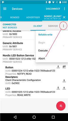

  • The BLE_GATTS_OP_PREP_WRITE_REQ operation must be handled (ie rejected or accepted). However, I think the problem is rather why the phone sends a prepare write request in the first place, it only adds overhead.
    There is a new option in the latest nRF connect update that enable reliable write. Maybe you have this option enabled? It still doesn't explain why you get this event with the blinky app though, according to the app developer it does not support prepare write.
    Please check if the Abort option is greyed out before you write to LED characteristic:
  • Fascinating.  At your request I looked at the Reliable Write selection in NRF Connect and 'Abort' and 'Execute' were greyed out, 'Begin' was not.  I pressed Begin and then Execute and Abort were highlighted.  I pressed Abort and it went back to Begin.  So, not knowing what affect this was having, I tried to write the LED characteristic again.  The App is NOW receiving Write Requests instead of the BLE_GATTS_EVT_RW_AUTHORIZE_REQUEST and the LED is toggling properly.  I can't explain it, but it's working now AND you did answer my original question.
