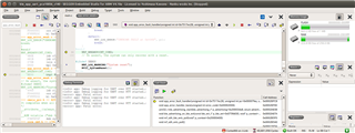

ble_app_uart fail about 180seconds
I run the "ble_app_uart" from sample program and leave it as it is.
The program ends in NRF_BREAKPOINT_COND with "Fatal error" after a while.
It is displayed as a screen shot as long as 180 seconds or less.
Environment:
  • SDK 15.2.0
  • SEGGER Embedded Studio Release 4.10a Build 2018110203.37618 Linux x64
  • Raitac MDBT-50Q DB (nRF52840)
    www.raytac.com/.../ins.php
Is there a way to avoid the error?
  • Hi.
    This happends because after 180 seconds the device should go to sleep.
    When the device is attempting to go to sleep, it calls sd_power_system_off(); in line 332 in main.c, this function call is not allowed while debugging.
    To avoid the error, simply don't call this function while debugging.
    Andreas
  • Hi , Thank you for the reply.
    Certainly, the description of sleep was in main.c. I also understood that entering sleep during debug will result in an error.
    I did not want to go to sleep, so I did the following.
    (cf., https://devzone.nordicsemi.com/f/nordic-q-a/10465/advertising-forever)
    With this, a long time advertisement has been realized.
    Thank you.
        uint32_t err_code;
        switch (ble_adv_evt)
            case BLE_ADV_EVT_FAST:
            case BLE_ADV_EVT_IDLE:
                // sleep_mode_enter();                                                // ( sleep after 180 sec )
                err_code = ble_advertising_start(&m_advertising, BLE_ADV_MODE_FAST);  // modify for infinity advertising
            default:
