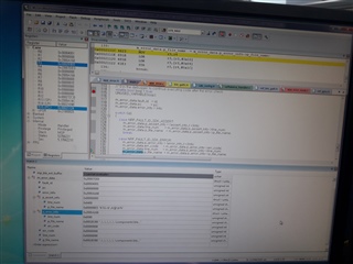

    You are getting error-code 8, that is NRF_ERROR_INVALID_STATE. How does the call stack look like?
    Could it be sd_ble_gatts_exchange_mtu_reply() in nrf_ble_gatt.c that is returning NRF_ERROR_INVALID_STATE?
    What SoftDevice version are you using ? S132 v3.0.0?  Could you test with S132 v3.1.0?

    I attached a log file and attached a call stack for peripheral ("A")

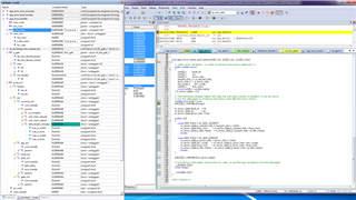

  • Hi, Sigurd
    Can not this happen?
    Or does this happen because the SDK version is different?
    I would appreciate it if you could give me a hint.

    Please see this post on how to debug this with Keil. Remember to set the Optimization level to 0, and add DEBUG as a Preprocessor symbol. Then post a new image of the call stack when you have done that.
