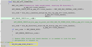

work on sdk15.2, pca10040 eavl board. one as central run this code
 \nRF5_SDK_15.2.0_9412b96\nRF5_SDK_15.2.0_9412b96\examples\ble_central\ble_app_multilink_central\pca10040\s132\arm5_no_packs
Another one as peripheral, run this code
 \nRF5_SDK_15.2.0_9412b96\nRF5_SDK_15.2.0_9412b96\examples\ble_peripheral\ble_app_blinky\pca10040\s132\arm5_no_packs
change connection interval to 10ms.

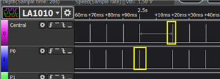

peripheral send one package to central per 10ms,there no data re-transmit when they are close, less than 80cm.
Once distance longer than 80cm, will happen re-transmit.
The environment is clear, no much interference.

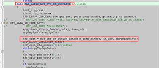

So what will affect ble performance except wifi/2.g interference.
Change tx power to 4dbm ,no help.
