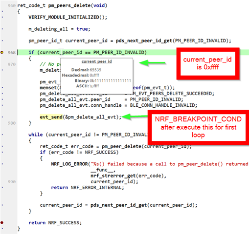

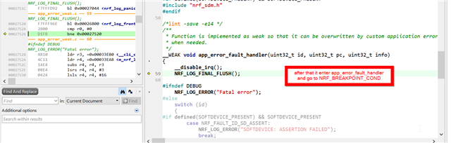

ble_app_hrs/ble_app_hrs_freertos example NRF_BREAKPOINT_COND when pm_peers_delete()
I enter problem when I tried to delete bonded data from my example code using pm_peers_delete()
SW: nRF5_SDK_15.2.0_9412b96
HW: PCA10056
example: ble_app_hrs_freertos/ble_app_hrs
1) Ensure the PCA10056 target is already bonded
2) Connect with autoConnect (nrf connect app)
3) Disconnect
4) Device crush with NRF_BREAKPOINT_COND thrown.

static void pm_evt_handler(pm_evt_t const * p_evt)
    bool delete_bonds = false;
    pm_handler_on_pm_evt(p_evt);
    pm_handler_flash_clean(p_evt);
    switch (p_evt->evt_id)
            advertising_start(&delete_bonds);

    This is an APP_ERROR_CHECK failure.which means that a function has returned with error and the APP_ERROR_CHECK caught it.
    If you compile your code without any optimizations and run it in the debugger, the execution will halt as soon as it hits the NRF_BREAKPOINT_COND. When you look at the call stack you can immediately see which function returned with which error and after reading the API documentation, you can go further to fix it.
    Can you tell us which functions returns what error code after your debug session? We can try to help you from there

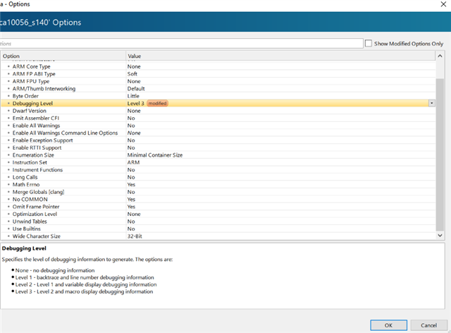

    Thanks for the update. But it was unfortunate even with the setting below I still see it crush.

  • I think you are talking about the evt_send where you see NRF_BREAKPOINT_COND in the first call of the registered handlers. I am not sure what handler is being called there, so it is hard for me to tell what happens there. Why can't you step into evt_send and see what is happening inside it. Step in  until you see exactly where the error happens.
    It first called CRITICAL_REGION_ENTER() and the problem starts when it call app_error_fault_handler and subsequent it enter NRF_BREAKPOINT_COND
    I am sorry for the late reply.
    The app_error_fault_handler() function is typically called because an error check has been hit. As you can see form the implementation, it behaves differently depending on if DEBUG is defined or not. If DEBUG is defined it will log details about the error (typically file name, line number and error code if it is in the application) to make it easier to debug. However, I see from your screenshot that you have not defined DEBUG for your project.
    We will be in a much better position to solve this issue after we have gotten all possible information about the error. Therefore, the first thing you should do is to define DEBUG and test again. When the error is hit you can either observe details from the log output or inspect the data using a debugger. You may also want to refer to An introduction to error handling in nRF5 projects.
