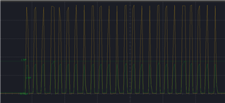

I figured out that the electricity of 1.2 V, 1.4 V or max 1.8 V indicates a 1, while the electricity of 58.59 mV indicates 0, as captured using my oscilloscope:
Using this configuration, I did not receive the output as I expected. Instead, the handler seem to be called every time a noise (as low as 39 mV) is detected (yes, the output of this LED string is really noisy, although there is no more data to be sent and the light is static).
Another problem is when I sent a bunch of data, the COMP seems not calling the handler as much as the data received. Instead, it only trigger once.
The yellow line is the signal created by the handler, and the purple line is the signal from the LED string after being stepped-down.
