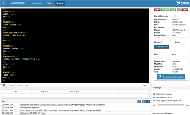

in getting my nRF9160-DK setup, no problem. I was unable to connect to the nRF Cloud so I installed the AT Client to debug as many others have on this forum. I have tried multiple locations outdoors and have been unable to see any towers. The iBasis eSim should work and there should be LTE-M coverage. I am in central Tokyo.
Here is the output from AT Client:

What should I try next? Thank you!

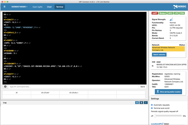

  • Thanks for the response.
    I updated the firmware and regretfully no improvement.
  • I don't think the problem is with the eSIM: I can't see any towers on band 3.
    I think LTE-M only functions on band 1 and band 8 in Japan. Can you confirm?
    NTT Docomo does operate on band 3, but it is for high speed LTE and I am not sure, but I am thinking it does not support LTE-M.

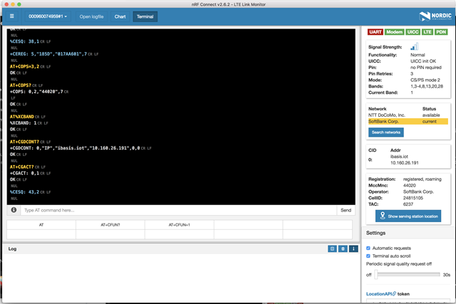

    I tested another LTE-M device and confirmed I can see NTT Docomo, KDDI and SoftBank towers from the location I am currently testing (on B1/B8).

  • I happened to have a business trip to Thailand and so tested the device there. I can confirm the device and sim work properly. So, this confirms my thought that the problem is with certification. I have contacted the sales rep here but haven't received a response yet.
  • Hi Yusuke,
    I was able to get in touch with a Nordic representative in Japan. We should be able to connect to the LTE network by summer if not a bit earlier. I will post here again once I have tested and verified.
