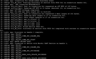

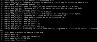

Hi, I'm working with nRF52832 DK,  SDK 15 on Windows with Keil5. I create Multiperiherial Nus with peer manager and fstorage and it works, but after some connetions I get an error in pm_conn_secure() error code 86.I dont know how many connections are needed for this error, maybe about 30. If i erase crystal in keil and programm nRF again i see that all working fine again and after some connections/disconnections error appears again.

    Could you try to see which NRF_ERROR pm_conn_secure() returns? It is much easier to know whats faulty then. There is documentation on how to debug on Keil's website here.

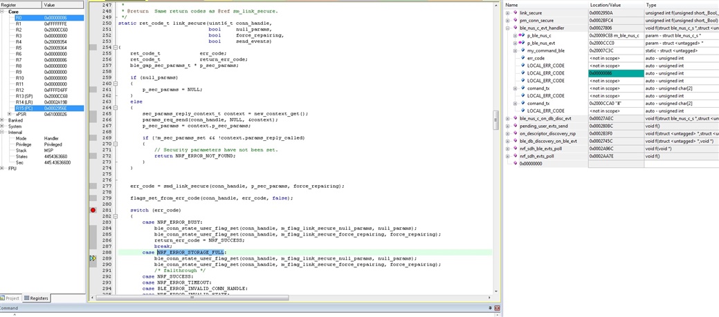

  • I see that link_secure() return NRF_ERROR_STORAGE_FULL
  • Hi.
    This happend because smd_link_secure(); returned NRF_ERROR_STORAGE_FULL.

    The error is returned because the is not enough room in your flash memory. You have to retry after the next FDS garbage collection procedure.
