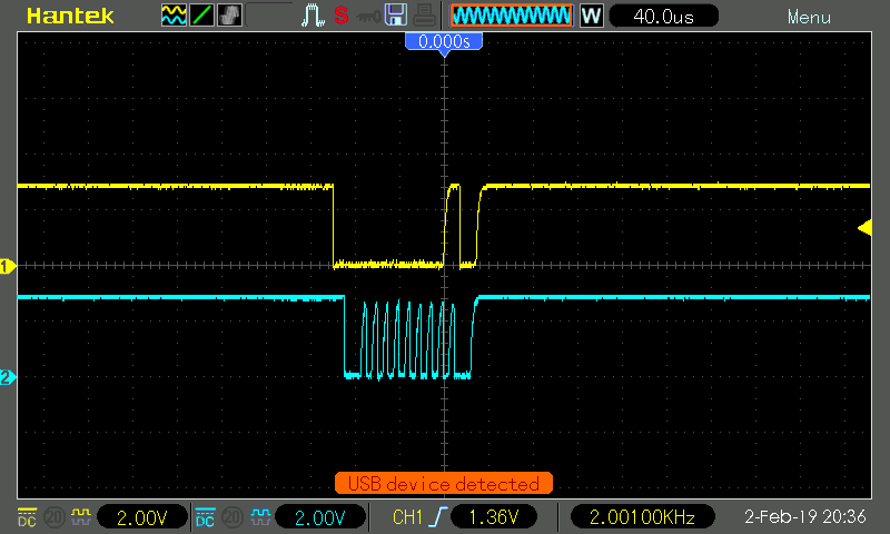

TWI only sending slave address, no data
Hello, I'm quite new to both the nRF52832 and the Segger Embedded Studio. I have a college project which involves I2C communication with 2 slaves. I was finally able to set up some sort of activity on the SDA and SCL pins, however, it appears that only the slave address gets transmited, no data. Of course I assume that I'm calling the function in the wrong way somehow, but I'm having a hard time understanding thow all the libraries work together. I have compared my code with the one used in the twi_sensor project, but I don't understand what I do wrong. Your help would be much appreciated.

    nrfx_twi_tx(&m_twi,address,&data,sizeof(data),false);
    nrf_delay_ms(5000);
Could it be because there is no acknoledge? (I'm probing without a slave to answer, I'm just testing the functions I will need)
