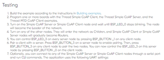

    sorry for late replay. iam studying about hread network thats the reason for late replay . I have some doubts regarding the thread example provide from nordic.Example provide by nordic is
    - Coap client
    -coap server
    -MTD coap client
    I have some doubts regarding the testing instruction:-
     1. according to 4th instruction another nodes programmed with client or server example and they will join as router or end device. ie,commisioning happen here for joining device to network.
               - Is it right?

  • Hi Alan
    1. - Yes, what the testing instructions says is correct.
        - There is not much security by default in these examples, so you would have to make your own. I would not count the PAN ID as a security measure as it is only a 2 byte ID.
    2. - I think commisioning and pairing in this case is the same thing. The commisioner in a Thread network is called Leader, and is the node sitting on all security information i.e. encrytpion keys and what nodes are allowed in the network.
        - The pairing process is whenever any server connects to any server in the Thread network. In this example you press a button on one server and one client node, to make them pair with each other. You can confirm pairing by seeing whether or not you can control BSP_LED_3 on the server node with a press of the clients BSP_BUTTON_0. A client node can only be paired with one server at a time, but you can change the server by repeating the pairing process with another server. (I will look more into security options, and get back to you when I have more information on the matter)
