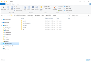

I am new to this , i am using nrf51822 for development , as the documentation says i downloaded the sdk and i got the nrf5 dk and i am using the Segger embedded studio , but i could not find the SES file as you mentioned in the YouTube tutorial

It is because we started supporting SES from SDK 14.1 and what I see from your screenshot you are using 14.0.

hello i found the ses file , but now i am in a different confusion , if you see the files you get
now which is the one i have to use in order to get working with nrf51822 and nrf52 dk
This will be a problem because last SDK that supports nrf51 series is SDK12.3.
You will need to create a new nrf51 project by yourself. Please familiarize with following tutorial:
devzone.nordicsemi.com/.../segger-embedded-studio-a-cross-platform-ide
There's a Getting Started Guide here. The most important part for you is probably Importing Keil projects.
