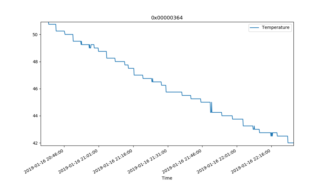

We are using the die temperature sensor on an nRF51822 we have observed a strange behavior. Some specific values seem to never be returned in the temperature value register. For example: we are never seeing the values for 49.75, 48.5, 47.25 and 46 degrees. These missing values are 1.25 degrees apart and this pattern, with a few exceptions, seems to be present at least from 40 to 70 degrees. The same values are missing on all units we logged. Is this a known issue and if so is there a workaround?
This is the code we are currently using:

    return temp;
This figure shows how some values are missing. Some steps are larger than the others. This does not seem to be due to the temperature changing too fast because the same values are missing on all the units.
