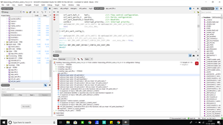

  • I have added the UART project( .c and .h files) which are present in the SDK v15.2.0 to the Mesh SDK v3.0 beaconing example and i have included the file paths also in the project,those modifications only i did..
    which IDE you are using? Segger embedded studio or any other for building the project
    As you suggested i will try to build the project  with fresh SDK's by making changes that you have mentioned above.
