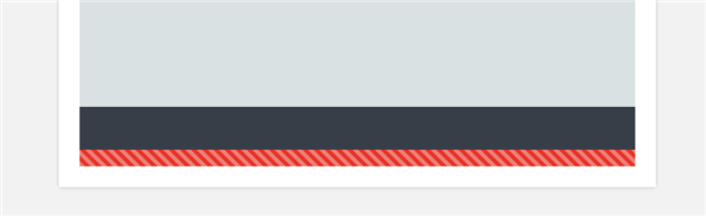

I have cloned the latest master repos and I am using the command line to build, compile, and flash. I have successfully built and compiled the new MQTT_simple example. However, when I try to flash it I noticed that it overwrites secure_boot.  When I pull the MQTT_simple zephyr.hex file into the nRF_Connect programming utility together with the secure_boot zephyr.hex I noticed that the images overlap!

Overlapping images from nRF_Connect Programmer tool.
