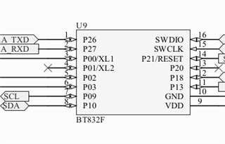

I use Twi for reading data from the lsm sensors. I want to use a twi_handler in which I will set the xfer_done_flag on the true and go off into a sleep mode until the flag is set to a false so that the sensors can successfully read the data. But the problem is that the TWI handler is not called. The problem is exactly in the software, as the example twi_sensor from sdk works.
twi initialization:
void twi_init(void) {
  const nrf_drv_twi_config_t twi_lsm330dlc_config = {
      .scl = SCL_,
      .sda = SDA_,
      .frequency = NRF_TWI_FREQ_400K,
      .interrupt_priority = APP_IRQ_PRIORITY_LOWEST,
      .clear_bus_init = true};
  ret_code_t error = nrf_drv_twi_init(&m_twi, &twi_lsm330dlc_config, twi_handler, NULL);
  APP_ERROR_CHECK(error);
  nrf_drv_twi_enable(&m_twi);
