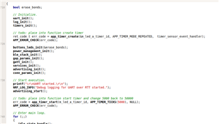

hi..... i am using nrf52832 , merged the uart and  timer example program . while i am debugging , debugged successfully , but timer is not working
actually i set the timer for one minute after completing the one minute it should send the data .  i am getting the data very quickly in this case i couldn't  found any timer

    static void timer_sensor_event_handler(nrf_timer_event_t event_type, void* p_context)
    nrf_gpio_pin_toggle(17);
    static void create_timers()
       uint32_t err_code;
        // Create timers
        err_code = app_timer_create(&m_led_a_timer_id, APP_TIMER_MODE_REPEATED,  timer_sensor_event_handler);
    static timer_start(void)
       uint32_t err_code;
        //uint32_t APP_TIMER_TICKS(50000);
        // Start application timers
        err_code = app_timer_start(m_led_a_timer_id, APP_TIMER_TICKS(50000), NULL);
         NRF_LOG_INFO("SUCCESS1");
        bool erase_bonds;
        // Initialize.
        uart_init();
        log_init();
        app_timer_init();
         create_timers();

  • Sorry about the verified answer. I was on my phone and finger slipped lol.
    Okay now that I see your entire c file it appears that you include #include "nrf_drv_timer.h" as well as app_timer.h.
    The handler below is for a timer using the nrf_drv_timer and not app_timer.
    Your init and application is using app_timer but it appears your handler is wrong.
    Handler should be
    static void timer_sensor_event_handler(void *p_content){}
    You should also be able to remove nrf_drv_timer.h and any drv/libs that you include in the application.
    I did a diff on your above code and the baseline ble_app_uart and there were no other changes.
  • edits I made.
    Change the location of APP_TIMER_DEF(m_led_a_timer_id); // this has no effect on the results
    I kept the timer_init function the same as the example. No need to change.
    Used the app_timer handler prototype instead of the nrf_drv_timer type. This is the change that provided working results.
    I didn't place your create and start in function but you can keep those in your functions as you have shown above.
    Last time I would suggest is not to use pin 17 (LED1) as your toggle pin. Reason being the default ble_app_uart application might be using LED1 for visual feedback. If you need to use LED1 make sure the ble handler is not controlling the pin as well. This will be something like bsp_indicator_set
