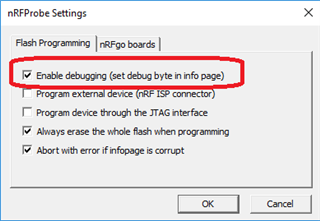

    2. I am with an impression that if I combine nrfgo mother board +nrf2722 i could download any program with target nrf24le1 and start debugging . Is my impression wrong? Because I could able to download program on to module but  keil IDE hangs as soon as I start debugging session.
    This is correct. With the nRF2722 module, the JTAG is routed directly to the chip itself, so that you can enter debug mode.
    Note that you have to enable the debug bit in order to do this:
    After this is set, flash the device once, then enter debug mode.
    In this mode, it will await a connection over JTAG, and will not run before you attach the debugger. If you want to return back to "normal mode", uncheck the debug section above, then flash again.
