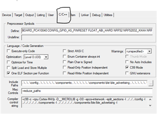

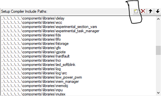

while merging blinky + timer , found an error nrfx_config.h: No such file or directory
hi.........
 i am tried to merge the blinky and timer sample program , i am getting this error , even i have included all files .h , .c files
  • you have to link this file and enable driver into SDK_CONFIG.h file.
  • I am using SDK 15.2.0-PCA10040-S132
    I merge Blinky code into timer code.
    Its showing 0 error.

  • good , but what mistake in my file i used application timer
  • I am using Keil tool. I didn't check your file?
    Above code working from my side.
    Please Post your code. I can't understand your problem?
    application timer
    which example it is?
    Please explain clearly.
  • look at this code
