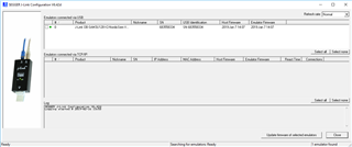

Hello guys,
everything worked fine for me (NRFConnect, Apps, CLI, Building with Segger Studio, Prgramming via NRFConnect Programmer, everything on Win10) but then I was trying to flash a Softdevice on the DK with the "nrfjprog"-Tool and somehow managed to erase everything on the board. Windows was not recognicing it as an COM anymore. By starting the DK with the "IF BOOT/RESET"-Button in bootloader-mode I flashed the Firmeware "J-Link OB-SAM3U128-V2-NordicSemi 170724" on the device. Now it apears as a COM-Port again and the status LED5 is shining again.
I can update the Firmware with JLINK to the newest Version:

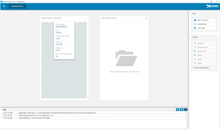

Sadly when I start the NRFConnect and the programmer and try to connect, it doesnt load the "Device Memory Layout" and I can not write, erase or anything else. Even though there is no error displayed.

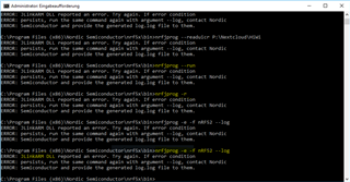

The nrfjprog gives me an Error no matter what command I try:
"ERROR: JLinkARM DLL reported an error. Try again."
But as I mentioned befor, I got a second DK here and this one just works as it should with no errors. I already tried to reinstall (JLINK V6.40 now V6.42d, NRFConnect) and update everything to the newest version:

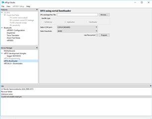

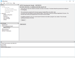

The nRFgo-Tool notices the DK with the correct serial number but prints the folowing message:
Recover and enable Pinreset is not possible.
I guess I deleted something importend (memory structure, bootloader, fimreware..) and need to flash something, but i dont know what. Note that I can choose nRF5x Bootloader, but not nRF5x Porgramming..
Running  nrfjprog -f NRF52 --recover --log  brings the following log:

___________________________________________________________________________________________________________________
My Setup:
Windows 10
nRFConnect
nrfjprog 9.8.1
JLINKARM 6.42d
nRF SDK 15.0
SDK for Thread and Zigbee
I tried:
- Using different USB Port
- Using different cable
- deinstalling the DK and driver in Windows Device-Manager
- reinstalling the complete Toolchain (Segger JLink, nRFConnect, nRFgo, nRFCommand-Line-Tools
- updating Firmware on the DK with JLINK
- Using the second DK and everything works just fine..
What is missing on my board to be in factory/default settings?
Thanks for your help, sorry for my lack of knowledge.
