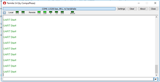

  • As a recap of the problem I am trying to solve:  I would like to redirect printf (or stop its current redirection) so that the compiled code operates without Segger Studio, just with a UART connection
    Does stdio.h define the standard output destination for putchar()?
    Rob

  • Andreas
    Thankyou for your time on this.
    I believe these only configure NRF_LOG instructions, not direct printf commands
    When using NRF_LOG_INFO commands with RTT set and UART unset I get data to the debug terminal in SES
    But with the same code with RTT unset and UART set I get no output to my serial monitor window
    What is the function of retarget.c?  Does it affect the destination for standard output?
    I am using the sdk_config for the peripheral/uart example from SDK 12.3.  I'll try the file you propose.
    How do I incorporate flash_placement.xml in the compiler configuration?
    Many thanks
    Rob

  • Hi.
    This is not what happend with the sdk_config.h file I gave you?
     It is an implementation of functions in stdio.h.
     Follow step 7 on this guide.
