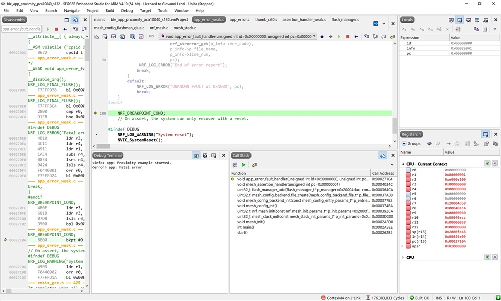

1. I tried first to run both the sdk_coexist examples(ble_app_uart and ble_app_proximity) on a nrf52DK(only version pca10040 is provided in SDK :-(, but even if they compile and NRF_LOG_INFO instruction works as expected by printing data on serial port, then they both fail when initializing the mesh, like in the picture below:

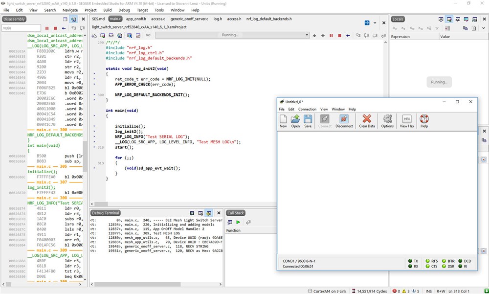

2. Then I tried to include nrf logging libraries in the *light switch server* example for nrf52840DK(pca10056). I included "nrf_log.h", "nrf_log_ctrl.h" and "nrf_log_default_backends.h" and initialized with NRF_LOG_INIT, like in the picture, below. In this case mesh works fine, log with _LOG method still works fine, but log over Serial with NRF_LOG_INFO doesn't work:

    1. Have you modified anything? What do you mean by "failed when initializing the mesh"? Does it fail when you try to provision it or when you compile the example?
    2. You should have a look at the proximity example and see how logging is initialized there. Then try to port the logging functionality from the proximity example to the light switch example.
    This post might be helpful also.
