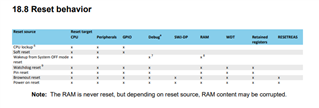

  • The pin should be set low when you configure it to "active high". Do you get a shorter pulse if you remove the 850 us delay?
    , the app_pwm library generates the PWM output signal with the TIMER, PPI, and GPIOTE peripherals instead of using the dedicated PWM module available on the 52 series. So this is a different implementation.
    When I set the pin to active high, I need not change anything as the driver (active high) will have the LED connected turned OFF.
    There isn't any difference in the pulse when I remove the delay or have it as the pulse is quite random. On few occasions, I won't even see the pulse/spike.
    Is there any startup time for the Mesh? Because, when we tried it with the 15.2.0 SDK, we can't see that initial spike while rebooting.
