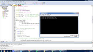

I'm trying to run fatfs example in sdk. I only changed the spi pin numbers. What is wrong with that?
* @defgroup fatfs_example_main main.c
 * @ingroup fatfs_example
 * @brief FATFS Example Application main file.
 * This file contains the source code for a sample application using FAT filesystem and SD card library.
#include "nrf.h"
#include "bsp.h"
#include "ff.h"
#include "diskio_blkdev.h"
#include "nrf_block_dev_sdc.h"
#include "nrf_log.h"
#include "nrf_log_ctrl.h"
#define FILE_NAME   "NORDIC.TXT"
#define TEST_STRING "SD card example."
#define SDC_SCK_PIN     5  ///< SDC serial clock (SCK) pin.
#define SDC_MOSI_PIN    6  ///< SDC serial data in (DI) pin.
#define SDC_MISO_PIN    0  ///< SDC serial data out (DO) pin.
#define SDC_CS_PIN      8  ///< SDC chip select (CS) pin.
 * @brief  SDC block device definition
NRF_BLOCK_DEV_SDC_DEFINE(
        m_block_dev_sdc,
        NRF_BLOCK_DEV_SDC_CONFIG(
                SDC_SECTOR_SIZE,
                APP_SDCARD_CONFIG(SDC_MOSI_PIN, SDC_MISO_PIN, SDC_SCK_PIN, SDC_CS_PIN)
         NFR_BLOCK_DEV_INFO_CONFIG("Nordic", "SDC", "1.00")
Here is RTT screen.
My schematic is;
CS-------------P0.08
MOSI----------P0.06
SCK-----------P0.05
MISO----------P0.00
Thanks..
