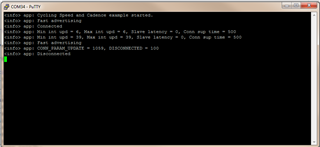

Hi everyone,
I'm new to working with Bluetooth/
My problem is that the connection interval time sent by the central device does not converge with the time I see using an oscilloscope or a configured timer for 1 ms.
The principle of operation of my program is that the peripheral device sleeps for a certain time and wakes up at a specified interval. The central device at this time is trying to connect to it. Using the timer, I count the time from when the device woke up to the time of the BLE_GAP_EVT_CONNECTED event and to the time of the BLE_GAP_EVT_CONN_PARAM_UPDATE event. The time difference between these events is about 600 ms. I can not understand why such a difference in time. Maybe I did not correctly understand the meaning of the parameters MIN_CONN_INTERVAL and MAX_CONN_INTERVAL? If so, then how can you reduce the time for a full connection, so that the BLE_GAP_EVT_CONN_PARAM_UPDATE event occurs as soon as possible.
To check what the actual value is transmitted by the central device, you can make a breakpoint during the execution of the program at the time of the BLE_GAP_EVT_CONN_PARAM_UPDATE event, which I actually did.
According to the received data, the central device set the value of the maximum and minimum interval of 7.5 ms.In the peripheral device, I have the following parameters:
MIN_CONN_INTERVAL    MSEC_TO_UNITS (7.5, UNIT_1_25_MS)
MAX_CONN_INTERVAL   MSEC_TO_UNITS (30, UNIT_1_25_MS)
SLAVE_LATENCY            1
CONN_SUP_TIMEOUT   MSEC_TO_UNITS (250, UNIT_10_MS)
I also read that the connection interval can vary from 7.5 ms to 4 s, maybe this value is the connection interval for my central device?

  • Hi
    Having some trouble recreating this. Are these logs when connecting to your phone or to the other nRF chip you have? Also, why are you waiting to transfer data until you get the last conn_params_update event? That shouldn't be necessary.
    I also have a question about your code snippet. Where does the time_conn [0-3] come from?
    Simon
  • Hi
    About the logs. If I understand you correctly, on the side of the smartphone I am not getting at the moment. Only in the manner described above, I get a report.
    "Also, why are you waiting to transfer data until you get the last conn_params_update event? That shouldn't be necessary."
    The last event I do not expect. As soon as I get to the BLE_GAP_EVT_CONN_PARAM_UPDATE event, I immediately start the data transfer. Due to the fact that for the first time the time interval parameters are set to 7.5 ms, the data does not come to the phone. Only with the following parameters data is received.
    About time_conn [0-3]. I set up a timer at 1 ms intervals and start it when the peripheral device wakes up.
  • Can you try to start sending data immediately after ble_evt_connected? You will likely get NRF_ERROR_INVALID_STATE in the beginning, but just keep trying until you get NRF_SUCCESS. This means that notifications aren't enabled, or that ATT_MTU exchange is running. It should not be necessary to wait until conns_params_update to send data.

  • Hi
    If I understand you correctly, you are proposing to start sending data right away when I get into the BLE_GAP_EVT_CONNECTED event. I tried to do this and the result did not change.
    I have an assumption that the first connection interval is always set to 7.5 ms. Perhaps during the first attempt, the peripheral device substitutes the ideal value of the connection interval to check if it is possible or not. After that, the central device rejects this value and sends back its values ​​for the connection interval at which a stable connection of two devices already occurs.
    Tell me, is this possible? I just have no more options, why I always see the connection interval = 7.5 ms when I first try to connect.

    uint16_t min_int_upd, max_int_upd, slave_conn_upd, conn_sup_upd;
      ret_code_t err_code = NRF_SUCCESS;
        case BLE_GAP_EVT_CONNECTED:
        app_timer_start(m_test_conn_timer_id, MY_TIMEOUT, NULL);
        NRF_LOG_INFO("Connected");
        case BLE_GAP_EVT_CONN_PARAM_UPDATE:
        min_int_upd = p_ble_evt->evt.gap_evt.params.conn_param_update.conn_params.min_conn_interval;
        max_int_upd = p_ble_evt->evt.gap_evt.params.conn_param_update.conn_params.max_conn_interval;
        slave_conn_upd = p_ble_evt->evt.gap_evt.params.conn_param_update.conn_params.slave_latency;
        conn_sup_upd = p_ble_evt->evt.gap_evt.params.conn_param_update.conn_params.conn_sup_timeout;
        time_conn[1] = time_conn[0];
        NRF_LOG_INFO("Min int upd = %d, Max int upd = %d, Slave latency = %d, Conn sup time = %d", min_int_upd, max_int_upd, slave_conn_upd, conn_sup_upd);
        if (max_int_upd > 6)
                                           BLE_HCI_REMOTE_DEV_TERMINATION_DUE_TO_LOW_RESOURCES);
        time_conn[2] = time_conn[0] - time_conn[1];
        NRF_LOG_INFO("CONN_PARAM_UPDATE = %d, DISCONNECTED = %d", time_conn[1], time_conn[2]);
        app_timer_stop(m_test_conn_timer_id);
        time_conn[0] = 0;
        NRF_LOG_INFO("Disconnected");

    I want to clarify about the part of the code that is described in the BLE_GAP_EVT_CONN_PARAM_UPDATE event.
    I make the disconnection in this way, because it is during the second connection that a stable connection occurs and you can already begin to transfer data. Just during the shutdown, I clearly observe how much time it takes to complete the connection.
    If disconnection is not done, then another 3 reconnections occur with the parameters of the connection interval equal to 997.5 ms.
    The time obtained using the timer, I also observe with an oscilloscope, so the time display is correct.
    I experimented with chips BT840F (analog nRF52840) and nRF52832 (on nRF52832 DK) and an example of ble_app_cscs. The results were getting exactly the same.
    Below is the result that I did on nRF52832:
    Thank you in advance
