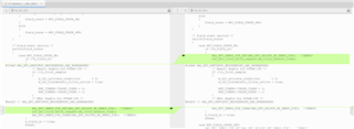

  • Hi David
    There is a bug in the FTPAN workaround which is only found if the HFCLK is already running while using NFC. This should be fixed in SDK 15.1 and newer, although the fix is quite simple for the 15.0 SDK as well. Replace your hal_nfc_t2t.c file with this,

    and it should work. This is the full fix, so there are some log functions that are changed as well.
    You can just replace these two lines in hal_nfc_t2t.c to apply the actual fix (Pic to the left is the fixed version).
    Simon
