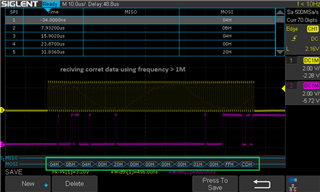

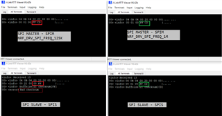

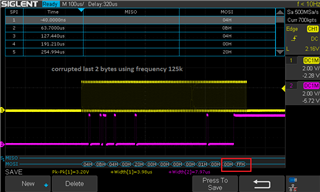

  • Hi Rohit, I used an oscilloscope to double check the data I was sending was good,
    testing: the only parameter modified on my test was the SPIM frequency
    RTT Terminal:
    1) test 1: NRF_DRV_SPI_FREQ_125K
    result: the last 2 bytes were wrong on the SPI MOSI, but the buffers use on the SPI master were OK
    2) test 2:NRF_DRV_SPI_FREQ_1M ( I was unable to measure 8M using my oscilloscope)
    results: all the data was sent with no issues when using frequencies >= 1M
